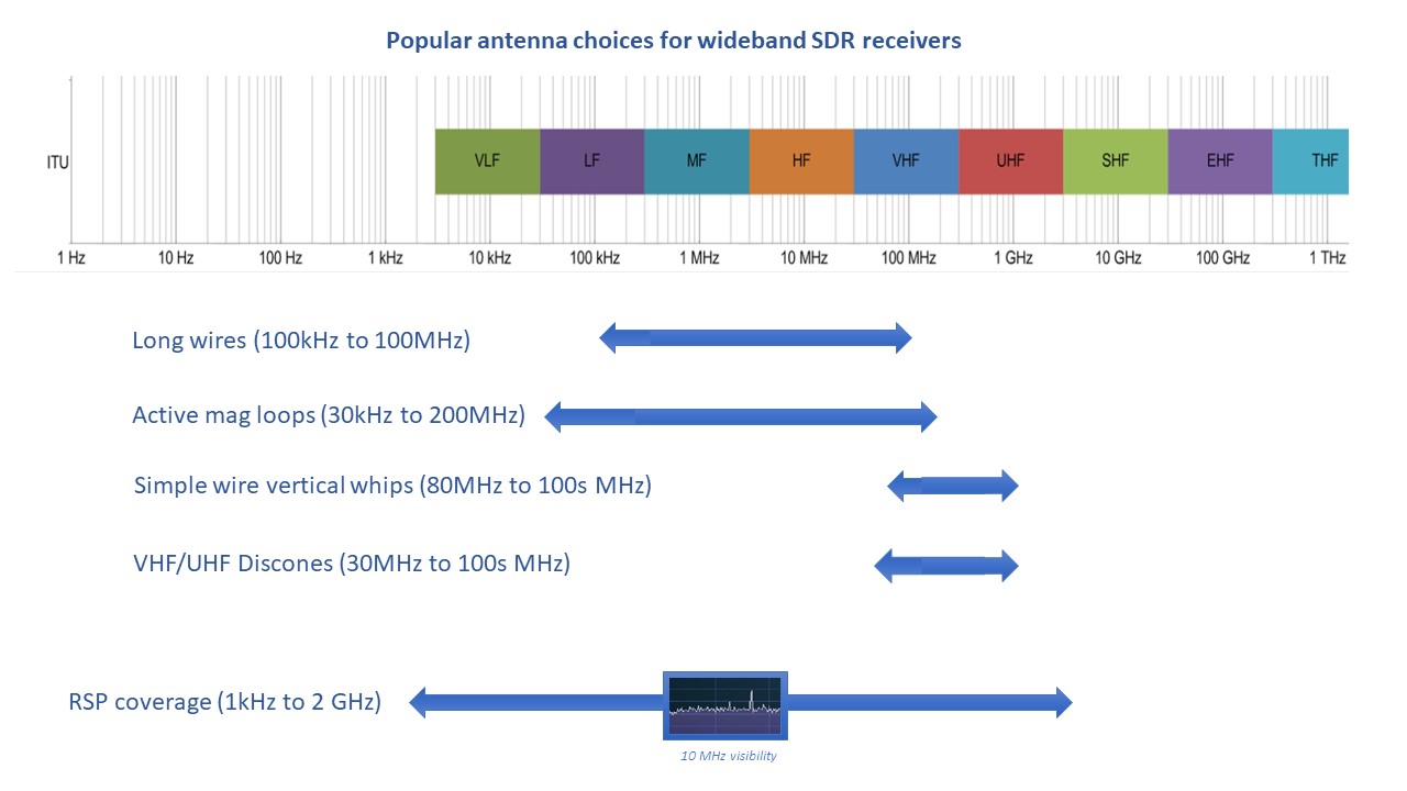

So you’re considering an SDR receiver or already have one. With any of the RSP family you have the possibility of receiving signals anywhere from 1kHz all the way up to 2GHz. That’s a lot of spectrum and no single antenna will give good performance over the entire frequency range. However it is possible to cover most of it with just 2 or 3 antennas.

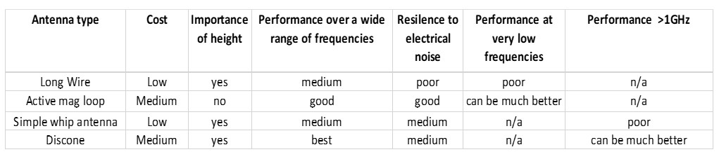

The picture above shows the four most popular choices of antenna for covering the bulk of the spectrum offered by wideband SDR receivers like the SDRplay RSP family. The “long wire” (more correctly named as the “random wire” antenna) and the whip antennas are the lowest cost options but have some limitations which is why the more expensive active magnetic loop and discone options have become popular. The key pros and cons are shown in the table below:

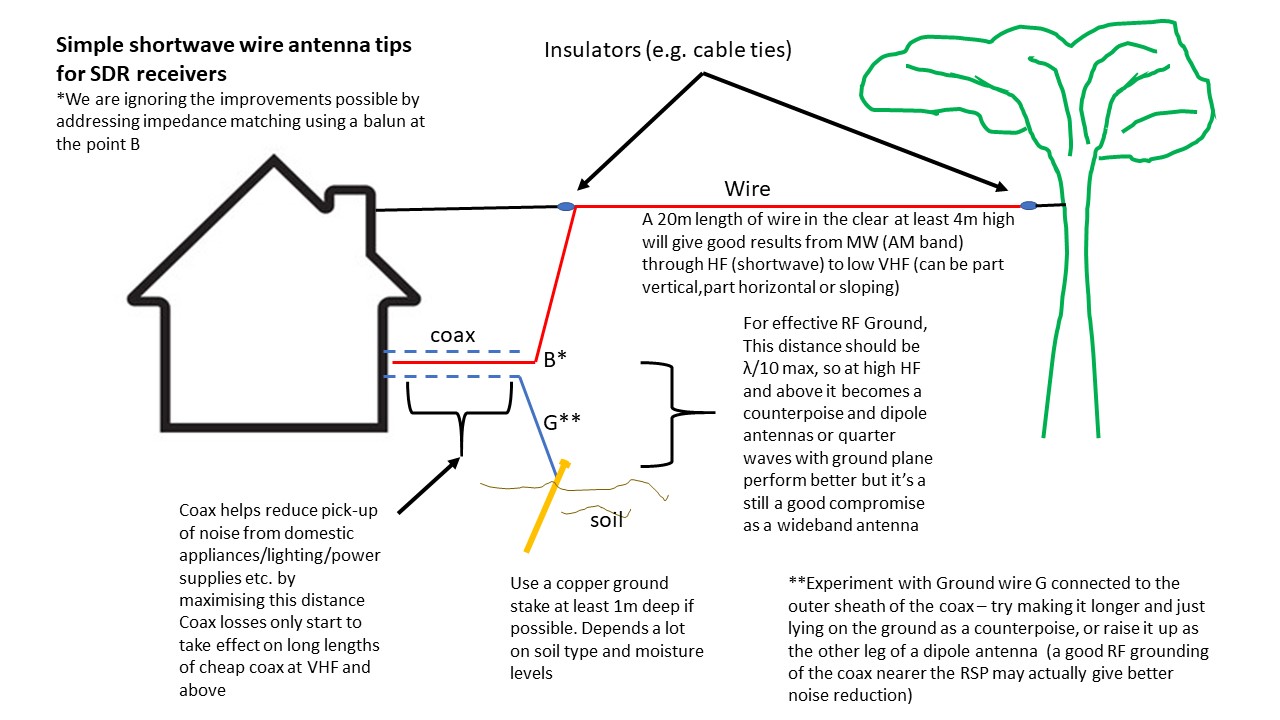

For HF there is a lot of scope for experimentation as illustrated in the following attempt to summarise some of the considerations. Trial and error can play a big role in getting the best signals and the least locally generated electrical noise:

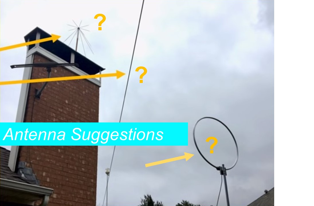

Recommended antennas for use with SDRplay RSPs:
SDRplay has had a good long term relationship with several antenna manufacturers (e.g. Bonito, Moonraker, SDR-Kits and so on). More recently we’ve been checking out specific antennas to add to our recommended list. All the antennas recommended have a good price/performance/functionality mix. Be sure to look out for the “Approved for use with SDRplay” badge on the antenna vendor’s website. Click here to find out more about the comparison videos we are creating.
